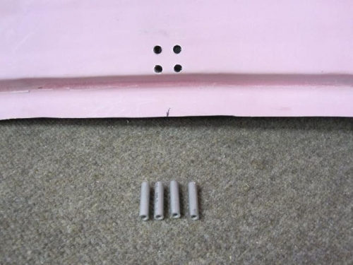

Final-Drill the four #12 holes in the top of the cabin cover using a 5/16" drill. Drill from the inside to the outside surface.
Cut four F-10106 Spacers from the length of AT6-058X5/16 tubing supplied in the kit. The length of the spacers is slightly longer than the thickness of the C-1001 Cabin Cover.

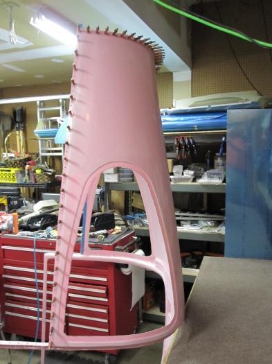

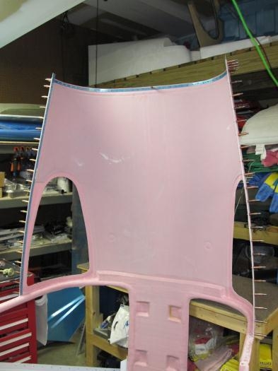

Locate the aluminum strip that was set aside on Page 10-12, Step 1. Final-Drill #30 the single hole in the middle of the strip, then cleco it to the inside of the C-1001 Cabin Cover.
Clamp the strip in several places along the tailcone forward top skin flange, then match-drill #30 all of the holes in the flange into the strip.
43-10, Steps 1 & 2
Clamp the F-10107 Rivet Backup Strips to the mid side skin flanges so that the bottom of the strips are even with the bottom of the flanges. Trim the ends of the strip which is on the tailcone forward top skin flange to clear the rivet backup strips.
Match-Drill #30 the holes in the mid side skin flanges into the F-10107 Rivet Backup Strips, then remove and deburr the holes in all three rivet backup strips.
Backup strips match drilled
Spacers cut and holes enlarged
