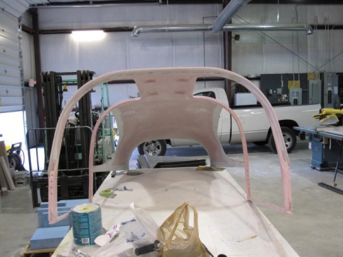

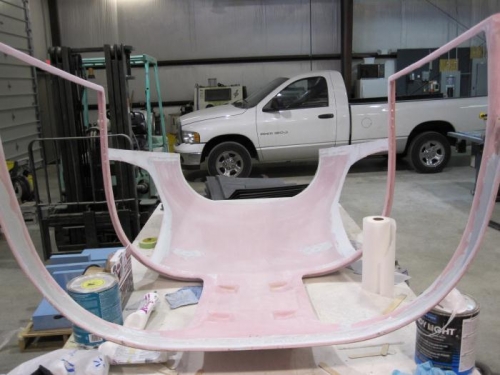

Another day working on the cabin cover interior. I put the third coat of body icing on the seat belt pads. I worked on the interior underneath the flange that the front windscreen attaches. This was in pretty bad shape with the surfaces being rough and the inside corner filet not being consistent. After about an hour of sanding, a coat of body icing, sanding, another coat of body icing, and then sanding it again, it now looks pretty good.
I sanded the rear window flanges smooth from the rough cuts that were done a couple months ago.
I wasn't able to get to priming the interior. Geoff Combs will prime it for me tomorrow. I'm planning on going back on Thursday to sand after the primer coat and patching as required so that that the final coat can be applied.
The front flange all iced up

Cabin cover all ready for priming
