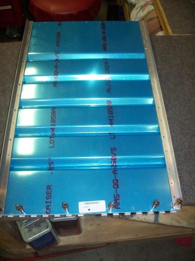

Align the bottom edge of the F-637B Left and Right Angles with the bottom edge of one of the F-637A Seat Backs. Align the vertex of the left and right angles with the side edges of the seat backs. Clamp the parts in position, then match-drill #30 the holes along the sides of the seat backs into the left and right angles. Repeat this step with the remaining seat back and the remaining left and right angles.
Drill 1/8” holes into two of the F-637C Angles using the dimensions given.
Nest one of the F-637C Angles under the flanges of one of the F-637A Seat Backs. The vertex of the angle will have to be filed to fit into the radius of the seat back. Align the ends of the angle with the edges of the seat back, then match-drill #30 the holes in the angle into the seat back. Repeat this step with the remaining seat back and angle.

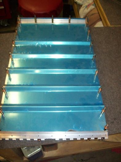

Remove the eyes indicated from the F-10103B-R Right Upper Seat Hinge Half and the F-10103B-L Left Upper Seat Hinge Half. These are the hinge halves that were set aside on Page 33-2, Step 5. Make the Right Seat Back Assembly by aligning the bottom edge of one of the F-637A Seat Backs with the F-10103B-R Right Upper Seat Hinge Half and one of the remaining the F-637C Angles.
Clamp the parts in position, then match-drill #30 the holes shown in Figure 3 into the right upper seat hinge half and the angle.
Make the Left Seat Back Assembly by repeating Step 5 with the remaining F-637A Seat Back, the remaining F-637C Angle, and the F-10103B-L Left Upper Seat Hinge Half.

Front of a Rear Seat
Back of a Rear Seat
