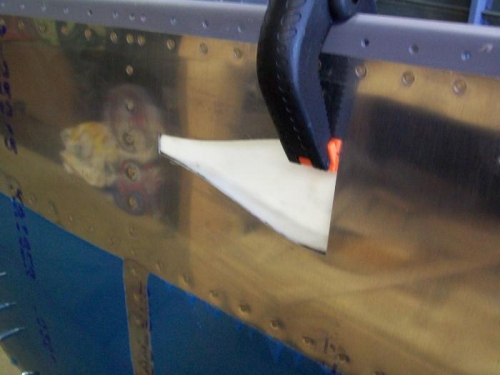

35-10, Step 3
Mix and apply tank sealant to the flange around the VENT SV-1 Remote Vent. Center the vent around the NACA shaped cutout in the F-1069-R Forward Side Skin then clamp the vent in place and let the tank sealant cure. I only have clamps to install one at a time. The left one was installed and the right one will be tomorrow.

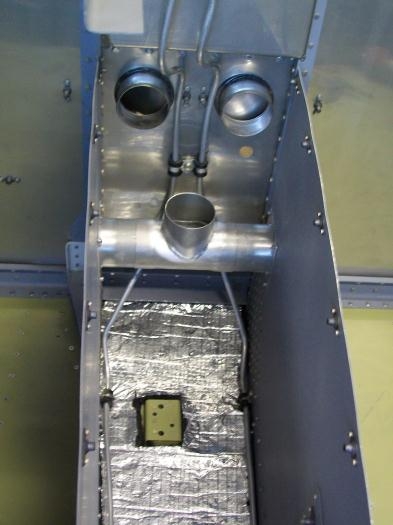

36-4, Steps 1 & 2
Insert the VENT DL-10 2.40 Flanged Ducts into the ends of the VA-175 Heat Duct Tee. Cleco this assembly to the F-1048-L and -R Fwd Fuselage Ribs.
Rivet the VENT DL-10 2.40 Flanged Ducts to the F-1048-L and -R Fwd Fuselage Ribs.
36-4 Completed per plans.

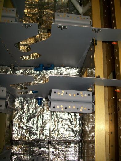

37-3 Installed AN6D fittings on each side of the tunnel. I was short one AN6D spacer, which I'll have to order from Van's tonight to complete the fuel lines.
Left forward NACA vent
Forward Heat Duct Tee
Fuel Fittings installed
