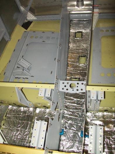

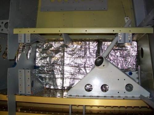

I insulated the tunnel and under the front seats today in preparation of installing brake and fuel lines. My thought would it would be easier to insulate now than after the lines have been installed.

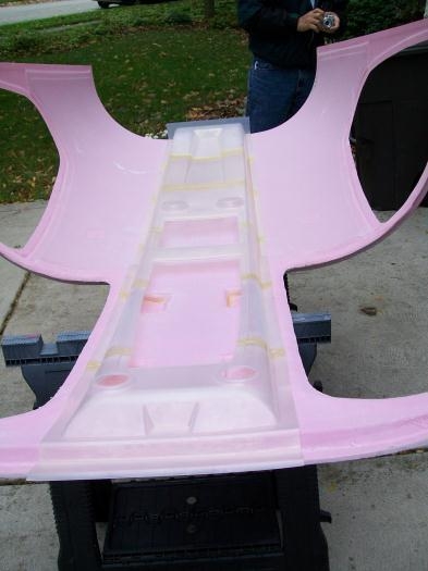

Geoff Combs brought over the stereolithography (SLA) mockup of Aerosport Products (http://www.aerosportproducts.com) new overhead console. It fits perfectly, which we anticipated since Cliff Walters designed the console using math data that was obtained by scanning my cabin cover. Hopefully in a couple weeks I'll have the final carbon fiber version.
SLA mock up of center console
Tunnel insulated
Tunnel insulated
Under the front seats insulated
