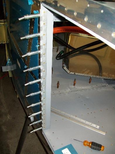

Remove the Baggage Door Assembly and the F-1058 Hinge Frame from the fuselage. Cleco the hinge frame to the F-1060 Hinge using the two holes drilled on Page 34-5, Step 7, then match-drill #40 the remaining holes of the hinge frame into the hinge. Deburr the holes of both parts.
Machine countersink the hinge for the heads ofAN426AD3 rivets. Machine countersink the hinge for the heads ofAN426AD3 rivets.
Attach 1/8" thick x 1/4" wide seal material (door and window weather strip tape can be used) to the F-1059E Skin about an 1/8" from the edges of the skin

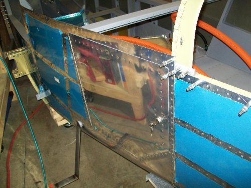

Separate the F-1058 Hinge Frame from the baggage door assembly by removing the hinge pin, then rivet the hinge frame to the Fuselage. Attach the Baggage Door Assembly to the F-1058 Hinge Frame by reinstalling the hinge pin.
Attach the F-1061 Striker Plate to the F-1031 Upper Baggage Door Seal Channel. Adjust the striker plate as needed to flush the aft end of the Baggage Door Assembly with the fuselage when the door is closed and locked.
34-6 Completed per plans
Hinge assembly ready for riveting
Completed baggage door
