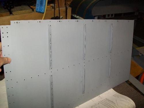

Rivet the F-1022 Baggage Floor Stiffeners to the F-1022A -L and -R Baggage Floors.

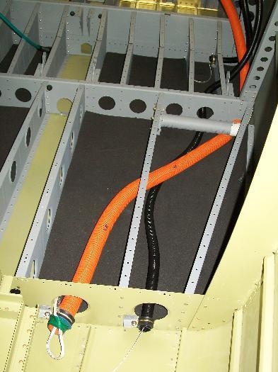

Finished pulling a .75" conduit to the comm antenna in the rear seat and to the tailcone on each side of the aircraft. Pulled a 1.23" conduit to the tailcone on each side of the aircraft. Installed adel clamps on each conduit.

Right baggage floor stiffners riveted
