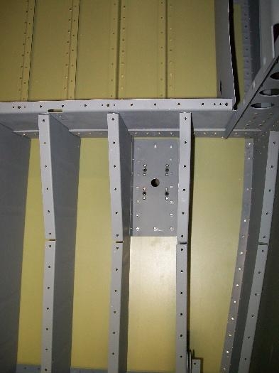

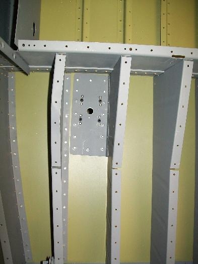

Brief Description:  Installed comm antenna doublers
Brad assisted me with installing the two comm antenna doublers between the rear seat ribs. We had to use the dimple dies on the rivet gun attachment to dimple the bottom fuselage skin. I was underneath the fuselage with the rivet gun and Brad bucked the rivets from above. Getting the blind rivets in the seat rib took a little bit of effort, but we got it done.
Right side doubler

Left side doubler
