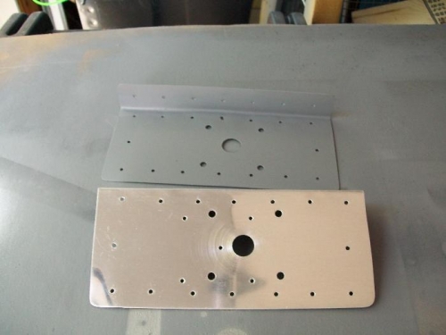

Brief Description:  Fabricate second antenna doubler

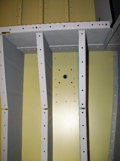

I decided to place the second comm antenna underneath the fuselage. I fabricated the second doubler, then matched drilled all the required holes. I then primed only the top side of the doublers to allow a better ground plane with the fuselage skin.
Matched drilled all the holes (this is the right side mount location)
Doublers primed, bottoms aren't primed
