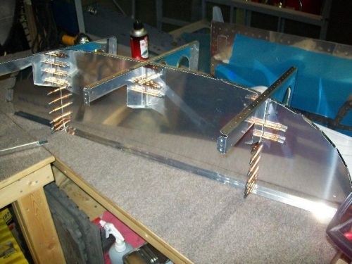

Brief Description: Finished inspection panel, started upper fuselage
Finished the inspection access panel on the tunnel.
31-3, Steps 2 & 3
Final-Drill #40 the nutplate attach holes in the F-1044A Fwd Fuselage Rib. Final-Drill #19 the nutplate screw hole in the fwd fuselage rib. Final-Drill #30 the rivet holes in the forward flange of the forward fuselage rib. Dimple the nutplate attach holes and the rivet holes in the forward flange of the forward fuselage rib.
Final-Drill #40 the nutplate attach holes in the F-1045-L & R Forward Fuselage Ribs. Final-Drill #19 the nutplate screw holes in the forward fuselage. Deburr all final-drilled holes in the forward fuselage rib. Dimple the nutplate attach holes and the rivet holes in the forward flanges of the forward fuselage rib.
31-4, Steps 1, 2, 3, & 4
Using the edge of a table or other straight edge, bend the lower portion of the F-1068A Sub Panel Center to 7.3 degrees.
Using the edge of a table or other straight edge, bend the lower portions of the F-1O68B-L and F-1068B-R Sub Panel Sides.
Cleco the F-1044A Forward Fuselage Rib, F-1044D, E, & F Angles, F-1045-L & R Forward Fuselage Ribs, F-1068A Sub Panel Center, F-1068B-L & R Sub Panel Sides, and F-1083 Control Cable Bracket. Final-Drill #30 all holes common to the parts clecoed together,
31-4 Completed per plans.
31-5, Steps 1, 2, & 3
Insert the F-1044B Angle and F-1044C Spacer through the angle shaped opening in the F-1068A Sub Panel Center. Cleco the angle and spacer to the F-1044A Fwd Fuselage Rib.
Remove the F-1083 Control Cable Bracket from the F-1068A Sub Panel Center. Final-Drill #19 the nutplate screw holes in the control cable bracket. Final-Drill #40 and dimple the nutplate attach holes in control cable bracket.
Using a long #30 drill bit, drill downward through the pilot hole near the middle of the F-1001B Upper Firewall Angle and through the upper surface of the F-1001K Firewall Recess.
31-5 Completed per plans.
Doubler for inspection panel riveted in place
Inspection panel cover screwed in place
Upper fuselage assembly cleco'd together.
