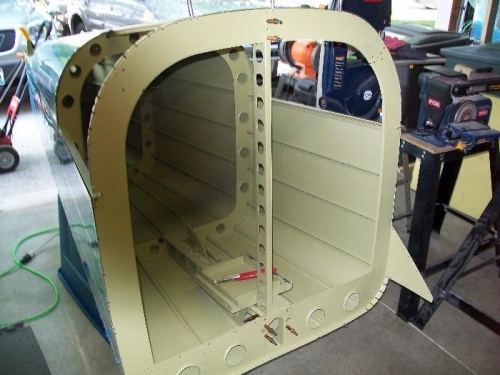

Bob Leffler's RV-10
Date: 6-27-2009
Number of Hours: 2.00
Manual Reference: 32-5
Brief Description: Dimple tailcone attach
32-5, Steps 1, 2, 3, 4, 5, 6, 7, 8, 9, & 10
Remove the tallcone from the mid fuselage and the F-1006 Bulkhead from the tailcone. Deburr all holes that have been drilled according to this section, and remove any chips from between the F-1070 Middle Side Skins and the F-1046 Middle Fuselage Longerons.
Dimple the holes in the skin flanges of the F-1006A, B, C, and D Bulkheads. Do not dimple the holes in the two tabs on both F-1006A and C Bulkheads which back-up the F-1032 and F-1046 Longerons. In all of the skins, dimple the holes which are common to the flanges of the F-1006A, B, C, and D Bulkheads
Dimple the aft most row of holes in the F-1077 Middle Bottom Skin and the corresponding holes in the F-1078 Tailcone Forward Bottom Skin. Dimple the ten holes along the top edge of the triangular, projected portion of the F-1 073-L Tailcone Side Skin. Dimple the corresponding holes in the F-1070-L Middle Side Skin. Dimple the three holes in both sides of the F-1074 Tailcone Forward Top Skin which are common to the F-1046 Middle Fuselage Longerons.
Set rivets in the six indicated holes in the F-1078 Tailcone Forward Bottom Skin, the F-1029 Bellcrank Ribs, and the F-1047 Stiffeners. Rivet the two nutplates to the small flange of the F-1006B Bulkhead. Rivet the F-1006B Bulkhead to the F-1006A and C Bulkheads. DO NOT set any rivets in the holes indicated in the figure. Rivet the F-1006B Bulkhead to the F-1029 Bellcrank Ribs.
