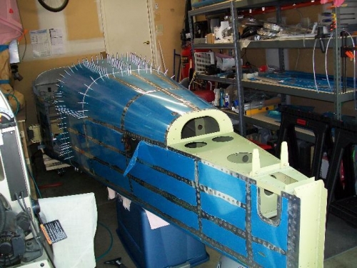

Tailcone clecoed - left side

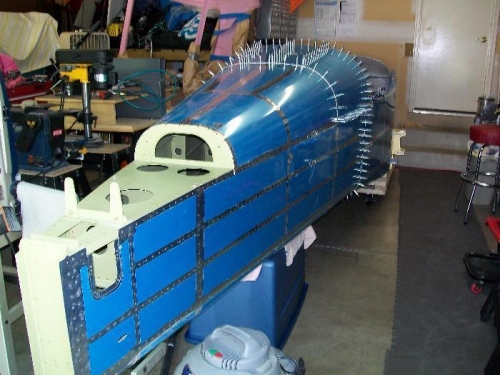

Tailcone clecoed - right side

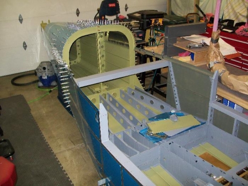

Tailcone attached to the fuselage  from the front
