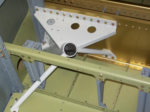

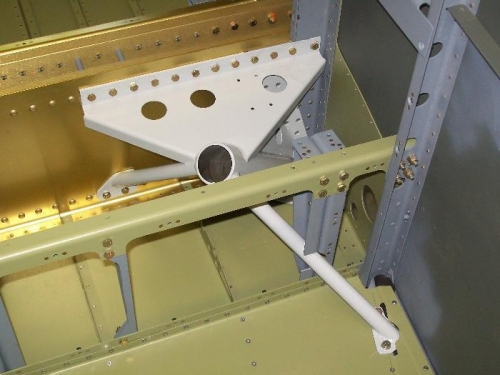

29-17, Step 3
Rivet the F-1015C Middle Cabin Decks to the F-1005C Bulkhead Side Channels.
Rivet the middle cabin decks to the F-1015B Foot Well Rib Intercostals per the callouts.
Rivet the middle cabin decks to the F-1042 Bulkhead Side Channels. Rivet the middle cabin decks to the F-1013 Forward Fuselage longerons.
29-17 Completed per plans.

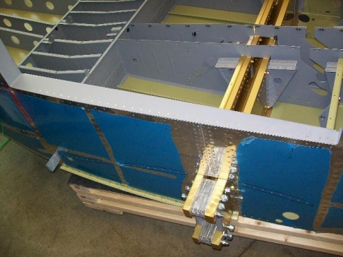

29-21, Steps 1 & 2
Cut a total of four F-1082 Spacers from AT6-058X5/16 tubing.
Install the WD-1021-L-PC Landing Gear Mount by bolting it to the F-1004 Center Section, WD-1021P Shim, F-1004K-L Center Section Side Plate, F-1069-L Forward Side Skin, F-1050-L Forward Floor Panel, and F-1049C-L Forward Fuselage Floor Rib. Repeat for the right side.
29-21 Completed per plans
Also, the project just passed 1,000 hours.
Right middle cabin deck
Left landing gear mount
Right landing gear mount
