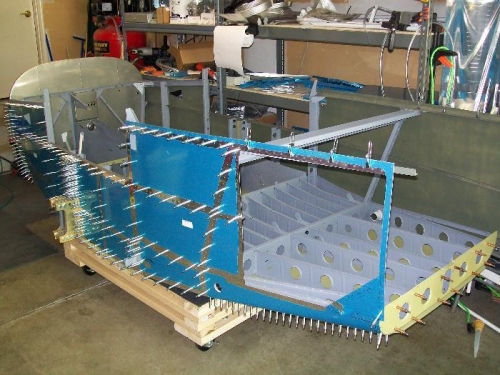

Cleco the F-1069-L and -R Forward Side Skins, F-1042B and C Clips, F-1015F Spacers, F-1070 Middle Side Skins to the fuselage assembly understructure. I finished the last three skins. Additionally, proseal was applied between the forward fuselage skins and the firewall to prevent CO from entering the cockpit.
29-16 Completed per plans.

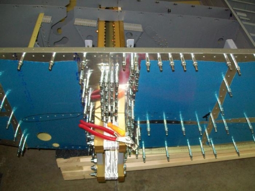

29-17, Step 1
Started riveting the double row of rivets on either side of the joint between the F-1 069 Forward Side Skins and the F-1070 Middle Side Skins.
