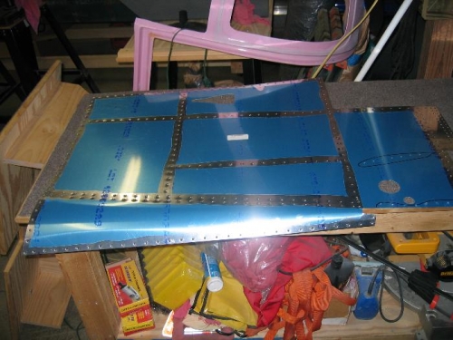

Brief Description:  More deburring and dimpling fuselage parts
29-15, Steps 1 & 2
Deburr and dimple the holes in the F-1 001A Firewall Bulkhead, F-1002-L and -R Forward Fuselage Bulkheads and F-1 088-L and -R Forward Fuselage Ribs that are common 10 the F-1069-L and -R Forward Side Skins. Deburr and dimple the single hole in the forward tab of the F-1088 Forward Fuselage Ribs.
Deburr and dimple the holes in the F-1015B Foot Well Rib Intercostals, F-1015F Spacers, F-1034C Fuselage Bulkheads, F-1023 Baggage Floor Angles and F-10100A and F-10101 Baggage Door Shims holes that are common to the F-1070 Middle Side Skins.
Using the callouts in Figure 1 deburr and dimple the F-1069 Fwd Side Skins and the F-1070 Middle Side Skins. I got the left forward skin completed. One down and three to go!

Left forward fuselage skin
