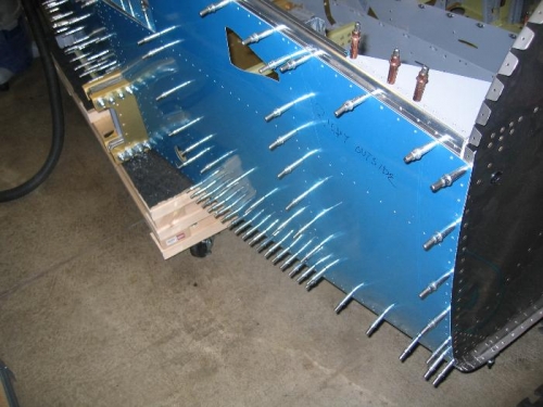

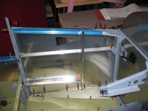

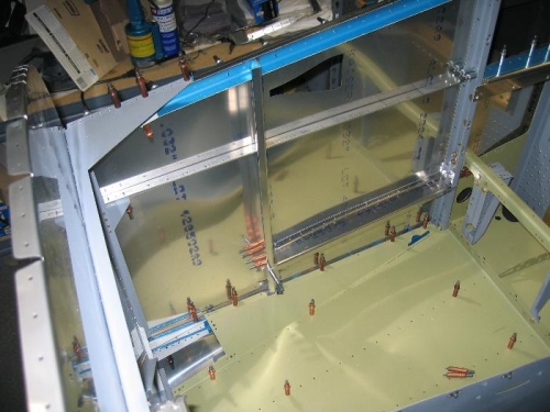

Cleco the F-1039J Rudder Pedal Drill Jig to the F-1013-L Forward Fuselage Longeron.. Repeat this step for the right side of the aircraft.
Match-Drill #30 the holes in the lower flange of the F-1040-L and -R Upper Fuselage Channels into the WD-1002-L and -R Upper Firewall Brackets.
Match-Drill #30 the holes in the F-1001B Firewall Upper Angle into the F•1040-L and -R Upper Fuselage Channels and WD-1002-L and-R Upper Firewall Brackets. Match-Drill #30 the remaining holes aft of the firewall brackets common to the firewall upper angle and the upper fuselage channels. Remove the cleco from the aft most hole common to these two parts and final-drill the hole #30 on both sides of the aircraft.
Match-Drill #30 the holes along the upper and lower flanges of the F-1 041-L and -R Lower Fuselage Channels into the WD-1 003-L-PC and -R-PC Lower Firewall Brackets.
Match-Drill #30 the holes along the outboard flange of the F-1050-L and -R Forward Cabin Floor Panels into the upper flanges of the F-1041-L And -R Lower Fuselage Channels.
