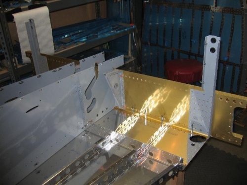

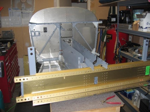

Brief Description: Forward fuselage con't
28-7, Steps 3 & 4
Match drilled all common holes.
28-8, Steps 1, 2, 3, 4, & 5
Trim the bottom flanges of the left and right center section side pates. Cleco the forward center section bulkhead assembly to the forward fueselage ribs. Match drill the #30 holes. Drill the #12 holes through the spar and forward fuselage ribs.
Next steps are to disassemble everything, debur, dimple, scuff, etch, alodine, and prime. It's not likely I'll get this done this weekend, so etching, alodining, and priming will have to wait for better weather that should be here on Wednesday and Thursday.
28-8 complete per plans
