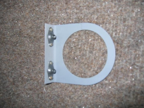

Attach nutplates to the the scat tube support bracket.

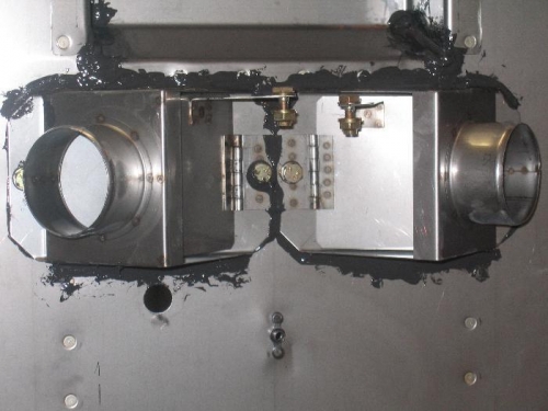

Insert snap bushings in firewall bulkhead. Bolt the cabin heat selector boxes to the firewall bulkhead. Proseal all gaps and holes to prevent fumes from the engine to enter the cockpit.

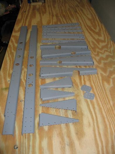

Break apart and trim the attach angles and seat support angles. Match drill attach angles, seat support angles, and outboard forward seat rail supports per plans. Debur, scuff, clean, and prime all parts.
28-2 Completed per plans
28-3, Steps 1, 2, 3, & 4
Match drill the inboard forward seat rail support assemblies and the bulkhead side channels. Debur, scuff, clean, and prime all parts.
Scat tube support bracket
Cabin heat selector box (after prosealed)
Parts all primed
