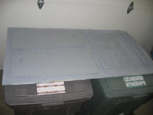

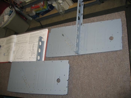

Cleco seat belt attach bar, outboard seat rib, forward seat belt anchor, seat rib intercostal, and spacer together per plans. Final drill all common holes. Dimple all holes per plan.
Debur, clean, and prime all parts.
Rivet the nutplates per plans. Rivet the seat belt attach bar, outboard seat rib, forward seat belt anchor, seat rib intercostal, and spacer together per plans.
Left and right outboard seat rib subassemblies complete.
Parts all primed
Parts all primed
Outboard seat rib subassemblies completed
