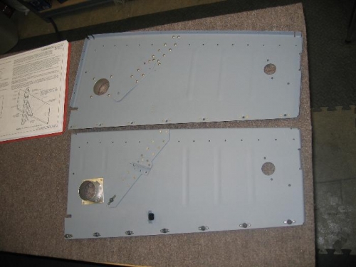

Left and right inboard seat ribs completed
26-2, Steps 5, 6, & 7
Machince countersink the two hole in the seat belt attach bars. Dimple all nutplates for #40 and #8 hole.

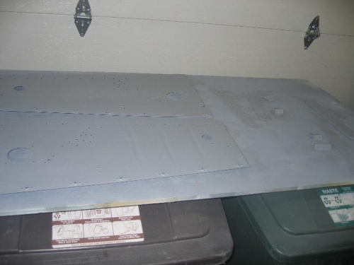

Debur, clean, and prime all parts.
Rivet all the parts per the plans.
Right and left inboard seat rib assemblies completed per plan.
Parts all primed
Inboard seat ribs completed
