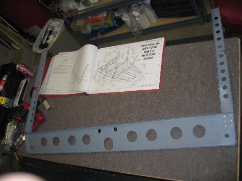

25-8, Steps 6 & 7
Rivet the gussets to the fuselage bulkhead. Rivet the fuselage bulkheads to the gussets. Install snap bushings into the fuselage bulkhead,

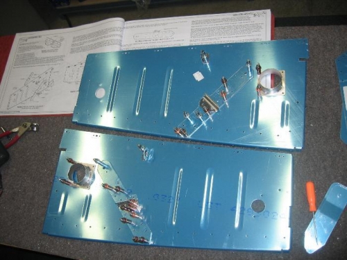

26-2, Steps 1, 2, 3, & 4
Cleco and final drill all common holes on the seat belt attach bar, reinforcing angle, scat tube flange, and left inboard seat rib. Final drill the nutplate holes.
Repeat of the right inboard seat rib.
Completed fuselage bulkhead
Inboard seat rib subassemblies
