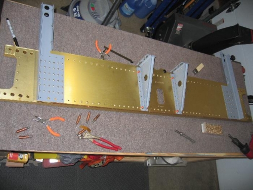

Brad and I finished riveting what I didn't complete the other day on the forward center section bulkhead.

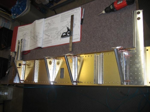

25-6, Steps 1, 2, 3 4, 5, 6, 7, and 8

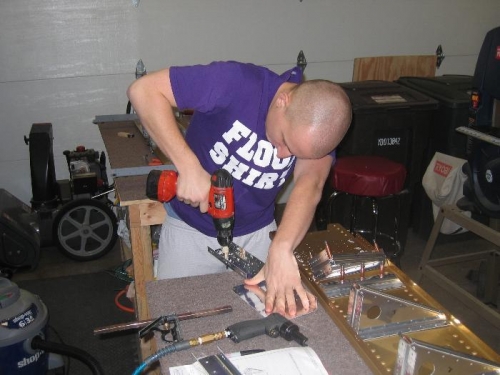

Match drill the various parts with the aft center section bulkhead assembly. While working on the hat stiffners, it was discovered that a large rivet was missing from the bulkhead. I called Van's and they confirmed that I'm indeed missing a rivet. They are sending out a AN3 bolt to fill the hole.
Tomorrow will bring deburring, cleaning, and priming all the parts I worked on today.
Brad enlaring the holes for the snap bushings with a unibit
The foward center section bulkhead assembly all complete
The parts for the aft center bulkhead assembly all match drilled
