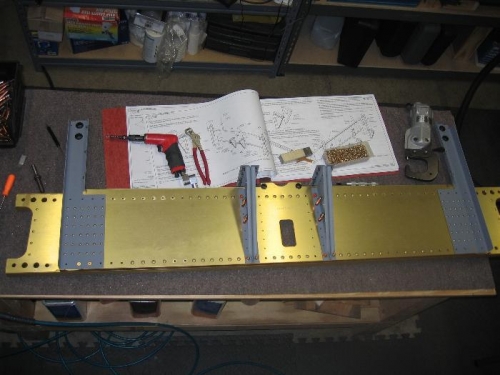

Riveting center section bulkhead
25-4, Steps 1,2,3,4,5,6, & 7
Cleco right and left mid seat rail supports together and rivet.
Cleco and rivet the nutplates of both mid seat rail supports.
Rivet the nutplates on the inboard flange of both center section bulkheads.
Bolt the mid seat rail support subassemblies to the center section bulkhead.
Rivet the stiffner angles to the center section bulkhead.
Insert snap bushings into the center section bulkheads,
Rivet the mid seat rail support assemblies to the center section bulkhead. (started, got about 25% done)
