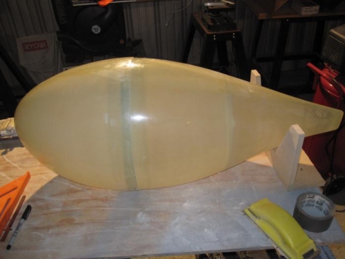

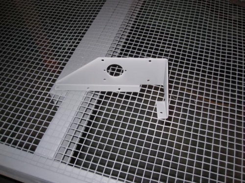

Brief Description:  Wheel Pants and Pitch Servo Mount
Use coarse sandpaper glued to a straight stick as a disposable file to remove any maleriallhat prevents the halves from matching smoothly. Take the time required to precision fit the wheel fairing halves. Assemble the U-1057A Wheel Fairing Front and U-1057B Wheel Fairing Rear. Tape them in this position and place a reference mark across the seam. Slit the tape on the seam with a razor blade and use this mark to realign the fairings during assembly.
Primed the mounting bracket for the pitch servo.
Wheel Pant
Wheel Pant
Pitch Servo Mounting Bracket
