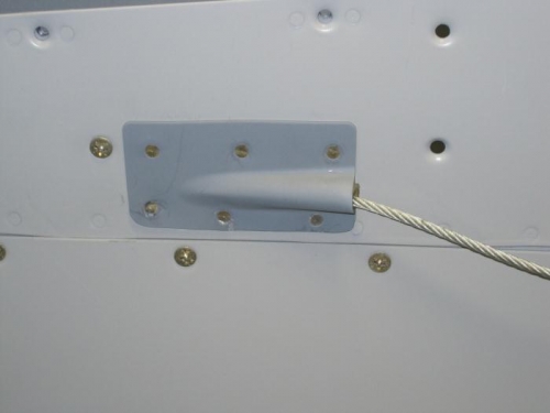

I deburred, scuffed, and cleaned the Avery fairings, then I primed them. Once primed, I riveted the fairings to the tunnel. I will mask off the fairings and final paint later so that the rivets are also painted.
