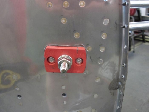

I worked on passing power through the firewall. I used the bulkhead connector from Blue Sea Systems to isolate the voltage from the firewall. I sealed the connector with proseal to prevent CO from entering the cabin.

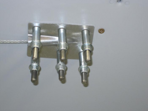

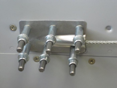

I also put Avery fairings on the rudder cables coming out of the tunnel. The right side had to be trimmed a bit to prevent block the tunnel access panel. I haven't decided if I'm going to rivet these in place or use screws.
