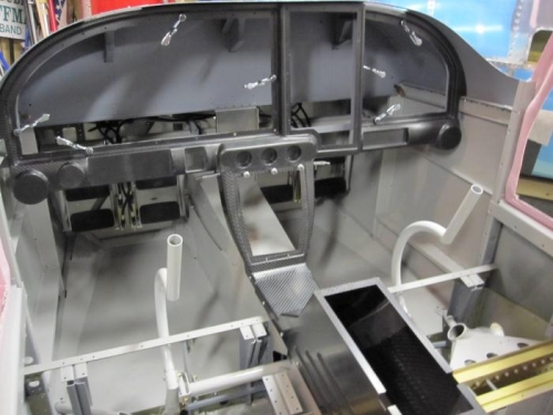

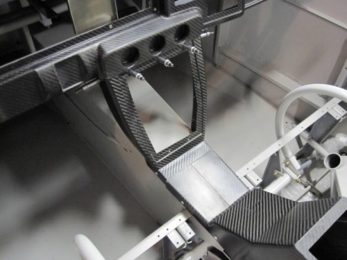

Brief Description:  Throttle quadrant #2
Brad assisted me today with installing the lower console module of the carbon fiber instrument panel. Using a strap duplicator we match drilled the hole with the tunnel cover. We did the same with the tunnel cover holes under the carbon fiber center arm rest console. We clamped in the throttle quadrant in prepartion for mounting the actual quadrant tomorrow.
