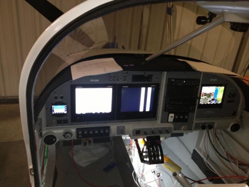

Brief Description:  AFS EFIS and GTN650
Troubleshooting an issue with the video screen on one of the AFS 4500s EFIS. AFS believes that there is a loose cable. It will be shipped back on Monday for repairs.
Also having a problem loading three databases on the GTN650. The only error message is "database not loaded" I was advised to re-download and re-install. Not only did I do that, but I did it to two data cards. I was unable to upload the databases from either databases.
