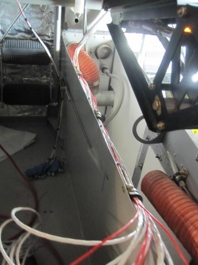

I had to re-route the audi console headset and power wiring that goes to the center arm console. It took awhile since it's all under the panel.

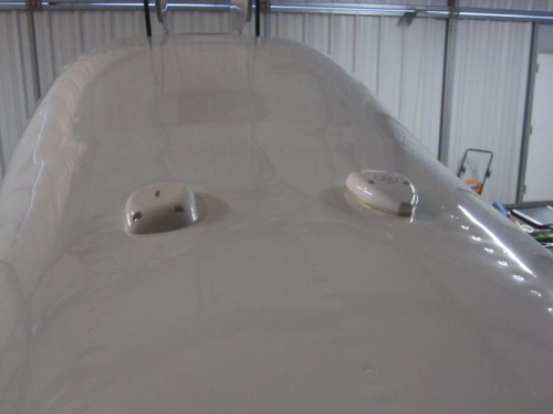

Screwed in the GTN650 and ADS600B GPS antenna.

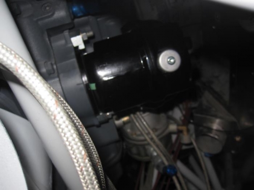

Joe Strausbaugh stopped by and helped me with the timing of the magnetos. Likes Thomas @ G3i informed me, just jumpering the modified pin to the P-Lead, enabled the magneto to be timed using standard methods.
