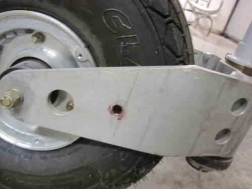

Brief Description:  Stick & Nose Wheel
I finished installing the helicoil on the left side of the nose wheel. Then I drilled, tapped, and installed the helicoil on the right side of the nose wheel.

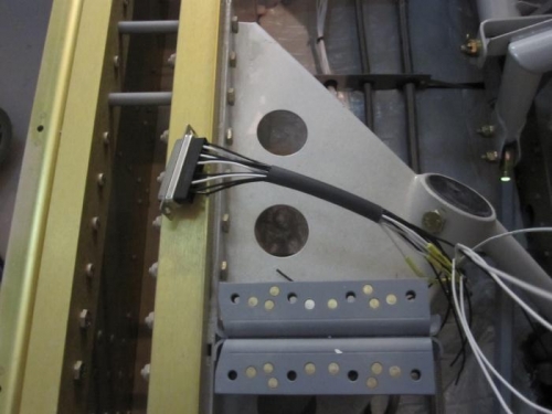

I ordered some heat tubing for my labeler and stop at hiome to pick it up on the way to the hangar. But then I left it on the counter. Since I couldn't finish wiring the right stick, since the next step would be to finish cutting the wires and labeling them. I crimped all the ground wires and installed them into the DB25 for the right stick.
