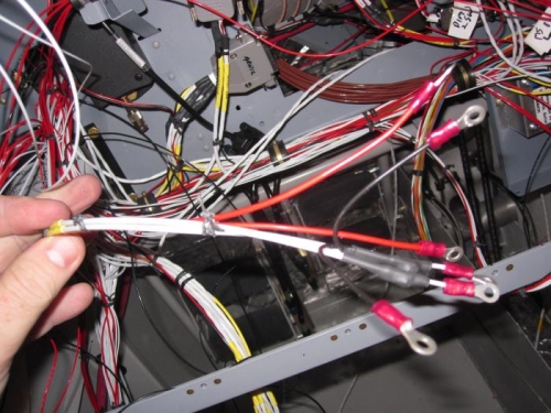

Brief Description:  Ignition Switch Wiring, Magnetometer Mount, & Door
I finished terminating the end of the ignition switch wiring and laced the wires.

Ignition Switch Wires
