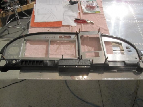

Modified and installed the moutning brackets for the AFS 4500s. Need to test fit with the autopilot and the Gemini PFD. I'll have to drill out a few rivets that I set today to take the left bracket off to trim for the PFD clearance.

Match drilled the insert mounting holes in the carbon fiber panel. There are a couple holes that moved from the original insert locations. The next session I'll need to see what impact that has on the panel support bracket.
Instrument Panel Inserts and AFS brackets
