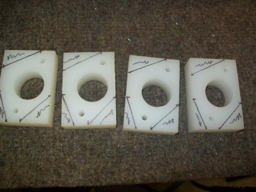

Trim the four F-1030 UHMW Bushings. Only one area must be trimmed for clearance while the other two areas are optional for a small weight reduction. It is acceptable to radius the corners of the UHMW bushings. Slide one F-1030 UHMW Bushing onto each WD-1013C Flap Torque Tube. This UHMW bushing will eventually be positioned to the inboard side of the system. This will form the Right and Left Subassemblies.

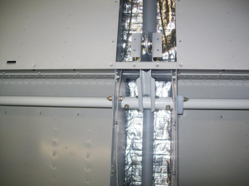

Install the Left Subassembly into the 1-1/8 diameter hole in the F-1016F-L Inboard Footwell Rib. Install a second F-1030 UHMW Bushing onto the Left Subassembly as it passes through the F-1016-L Outboard Footwell Rib. Repeat for the Right Subassembly. Slide the Left and Right Subassemblies outboard. Lower the WD-1013A Flap Crank into position then insert the left and right subassemblies into the flap crank. Rotate the F-1030 UHMW Bushings into position with the thicker wall forward. Bolt the UHMW bushings in place.
40-5 Completed per plans.
Bushings marked for trimming

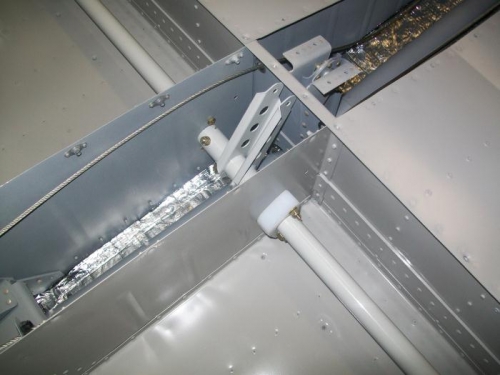

Flap crank and bushings installed
