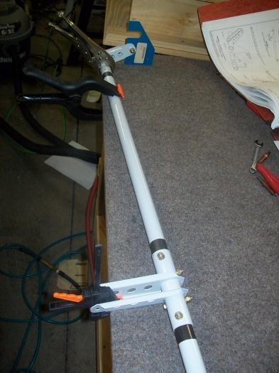

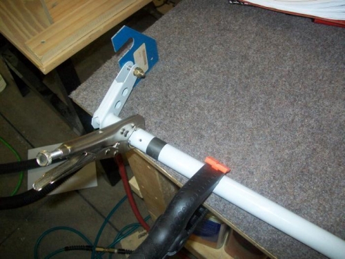

40-3, Step 1
Clamp the WD-1013A Flap Crank to a flat table. Bolt the W-730 Bellcrank Jig to the WD-1013B Flap Horn. I managed to misplace my jig and borrowed one from Rick Gray. This will set the angle of the flap horn relative to the flap crank. Set the lateral position of the flap horn. Clamp the flap horn into this position using a vise-grip placed over the inboard set of 1/8” diameter holes. Leave this vise-grip in place while removing the other clamps holding the assembly to the table. Match-Drill #30 the flap horn using the outboard set of 1/8 diameter holes in the WD-1013C Flap Torque Tube as guides. Continue drilling to final size as per the callout. Insert hardware. Remove the clamp.
40-3 Completed per plans.

Bellcrank Jig and the Flap Horn
Flap torque tube clamped to the work table
