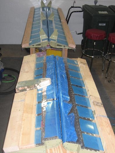

Brief Description:  Prosealed traling edges on flaps and ailerons
Janice and Renee assisted me today in prosealing the trailing edge AEX wedges on the right and left flaps and the right and left ailerons. These need to set for a couple days before riveting.
I also applied some proseal on the spot of the fuel tank that I weeped the green loctite 290 into the leak. I'm hopeful that both will resolve the leak issue on this tank. I think it will since the tank did hold the vacuum overnight.
