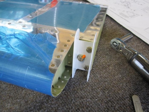

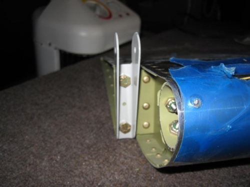

Fabricate A-1012 and A-1013 Spacers from AT6-058 x 5/16 material. Install the A-1007-L Inboard Hinge Bracket. The hardware called-out in for attachment of the inboard hinge bracket to the wing will be used during completion of the aileron actuation system. Install the A-1006 Outboard Hinge Bracket. The hardware called-out in for attachment of the outboard hinge bracket to the wing will be used during completion of the aileron actuation system 23
