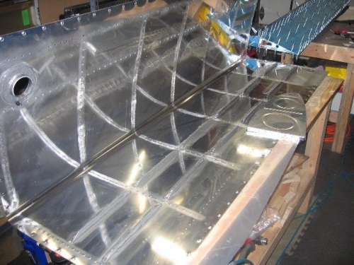

Brief Description:  Right fuel tank and right flap
18-4 Riveted and prosealed the stiffners on the top and bottom of the right fuel tank skin. Riveted and prosealed the fuel drain and the fuel filler ring.
22-5 Cleco'd the top and bottom skins, leading edge skins and the trailing edge to the spar and ribs in preparation to match drill on the right flap.
I also finished the last set of patches on the tooling holes on the end fuel tank rib.
Right fuel tank skin w/ stiffners prosealed and riveted
