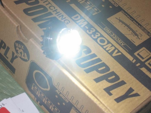

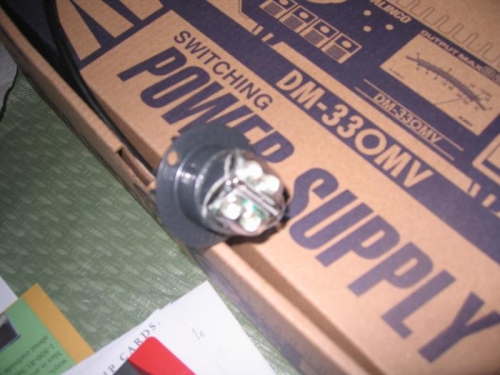

Brief Description:  CreativAir LED Postion/Strobe
I received the CreativAir LED tail position/strobe light today.
I hooked it up to the bench power supply. The LEDs do radiate RF when they flash. It could be heard on my handheld up to about 10-12 feet away. I don't know if there is any noise on the line yet. I am talking with a couple ham buddies to work through the issues.
