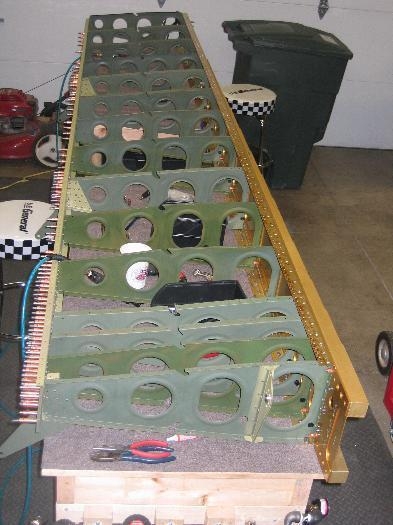

Brief Description:  Continue riveting the left wing
Left Wing
14-5, Step 3. Rivet the wing ribs to the spar. Brad assisted me with the bucking. I did not rivet the top and bottom of the wing ribs to the spar flange yet. I'll wait until I flip that spar on end to make riveting both sides easier. I also installed all the AN3-x bolts that attach the wing ribs to the spar. After being torqued to the appropriate amount, I applied the lacquer torque lock.
14-4, Step 1. Installed the snap bushings for the pitot line in the wing ribs
I started working on installing clecos for 15-2+, which is attaching the rear spar. I started gettig tired, so I thought it would be best to wait until tomorrow to rivet.

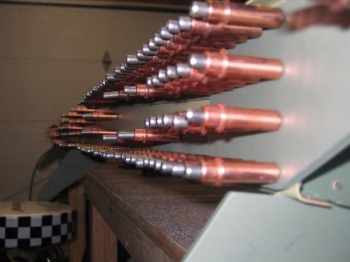

Plenty of clecos on the rear spar
