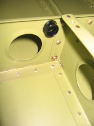

10-21, Step 2, When attempting to put in the rivets attaching the bellcrank rib to the bulkhead, I really screwed up one rivet a couple weeks ago. I attempted to drill it out, but ended up with a larger hole. I really hate drilling out AN470 rivets. I ended up replacing with a screw, a couple washers, and nut
10-31 Steps 3 & 5, Riveted teh aft deck to the longerons, along with the F-1011 bulkhead, elevator stop, and hosrizontal stabilizer attachment bar support.
I also manage to drop my parts container holding about a dozen types of rivets on the floor breaking the cover and dumping many hundreds of AN4263-3, 3-3.4 and 3.-4 rivets on the garage floor. I'm not looking for to separating these.
Replaced a rivet with a screw
