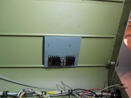

I started off the morning fabricating a mounting panel similiar to the one I purchased from Van's for the ELT. I'm going to mount two schottky diodes and the the DB-9 for the maintenance port of the ADS-600B.
I noticed that there were some issues with the DB connector for the ADSB, so I will analyze tonight and develop a plan to implement tomorrow.

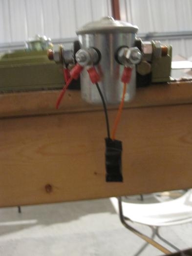

I installed a pair of nutplates on the battery tray for a cross feed contactor. This will be used to isolate the ground power circuit. I installed an OVM-14 on the contactor.

Schottky diodes mounted
OVM-14 wired to the contactor
