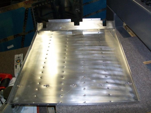

Final-Drill #19 the screw holes and Final-Drill #40 the corresponding nutplate attach holes in the bottom face of the F-1016C-L Floor Pan. Final-Drill #30 the remaining holes in the bottom face of the floor pan.
Deburr the holes and edges of the floor pan and the holes drilled in the under structure in Step 2. Dimple all the rivet holes in the bottom face of the floor pan. Dimple the screw holes in the bottom face of the floor pan for the head of an #8 screw (flush face on top side).

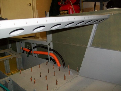

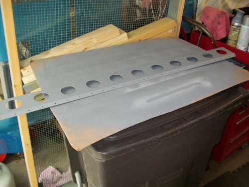

Cleco the F-1034F Seat Back Brace Closeout to the F-1034B Seat Back Brace. Final-Drill #30 the holes common between these two parts. Un-cleco, then deburr the holes and edges in the seat back brace closeout and the holes in the seat back brace. Scuffed, cleaned, and primed the Seat Back Brace.
Cleco then rivet the F-1034F Seat Back Brace Closeout to the F-1034B Seat Back Brace.

Seat Back Brace primed
Seat Back Brace installed and riveted
Rear seat floor pan dimpled
