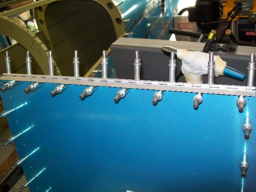

34-3, Step 4
Place the F-1060 Hinge on the F-1059A Forward Frame, not more than 1/16" above the lower mark made in Step 1. With the center of the hinge-pin aligned with the edge of the F-1 059ESkin, match-drill all the 3/32" holes of the hinge into the forward frame using a #40 drill. (Make sure there is at least a 0.025" gap between the hinge and the forward edge of the skin as shown in the blow-up. Trim the skin if necessary. The gap will prevent the skin from scraping paint off the hinge when the baggage door is opened and closed.)
34-3 Completed per plans

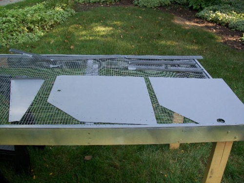

34-4, Steps 1, 3, & 4
Completely disassemble the baggage door assembly, and then deburr the holes in all of the parts.
Dimple the #30 holes in the F-1059F Close-Out Panel and the corresponding holes in the underlying structure. Except for the #40 holes in the F-1059A Forward Frame which are common to the F-1060 Hinge, dimple all #40 holes in the remaining parts.
Deburred, cleaned and, primed all the parts.
Baggage door hinge final drilled and clecoed
Baggage door parts all primed
