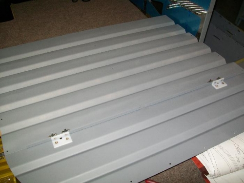

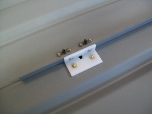

Cleco together the F-1006E and F Baggage Bulkhead Corrugations. Center the F-6114B and C Wear Blocks on the shoulder harness cable notches in.both sides of the F-1006E Baggage
Bulkhead Corrugation.
Match-Drill #30 the 1/8" holes of the F-6114B and C Wear Blocks into the F-1006F and E Baggage Bulkhead Corrugations respectively. Separate the baggage bulkhead corrugations.
Match-Drill #40 the nutplate attachment rivet holes in the F-1006F Lower Baggage Bulkhead Corrugation.
Rivet the nutplates shown in Figure 4 to both ends of the F-1006F Baggage Bulkhead Corrugation. Rivet the F-6114B Wear Block to the F-1006F Lower Baggage Bulkhead Corrugation using LP4-3 blind rivets. Install the rivets from the top of the wear block.
Rivet the F-6114C Wear Block to the F-1006E Upper Baggage Bulkhead Corrugation using LP4-3 blind rivets. Install the rivets from the front of the baggage bulkhead corrugation, and back up of the wear block with the washers shown.
33-10 Completed per plans
Wear blocks riveted
Wear blocks riveted
Baggage Bulkhead ready to install
