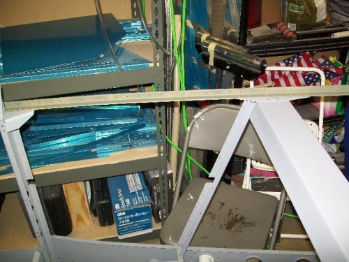

Bulkhead side channels finished countersinking

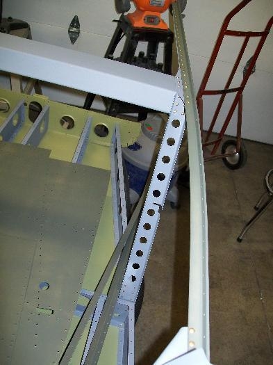

Right side of the seat back and longeron
Left side of the seat back and longeron
