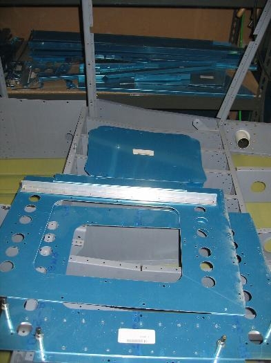

Brief Description:  Started seat floors
28-14, Steps 12 & 13
Fabricate two F-1067C Seat Floor Angles from AA6-063 X 3/4 X 3/4
Final-Drill #19 all the holes in the F-1067B Seat Floor Covers
28-15, Steps 1, 2, & 3
Break apart the F-1067A Seat Floors and F•1067D Seat Floor Attach Strips. File off the remnants of the "bridges" from the edges of each part and debur all the edges of the seat floors and seat floor attach strips. Final-Drill #19 all the screw holes in the seal floors and seat floor attach strips.
Cleco one of the F-1067D Seal Floor Attach Strips to one of the F-1067A Seat Floors as shown in Figure 2. Figure 2 depicts a "left-side" seat floor configuration. Cleco the remaining seat floor attach strip to the remaining seal floor in a "right-side" configuration.
Final-Drill #40 the holes common between the seat floors and seat floor attach strips. Cleco one of the F-1067C Seat Floor Angles to the "left" seat floor. Cleco the remaining seat floor angle to the right seat floor
Align the centerlines drawn on the seat floor angles with the holes punched in the seat floors and match-drill #40 the seat floor angles using the holes in the seat floors as a drill guide
Final-Drill #40 all nutplate attach holes in the F-1067A Seat Floors and F-1067D Seat Floor Attach Strips. File off the remnants of the "bridges" from the edges of each part and debur all the edges of the seat floors and seat floor attach strips. Final-Drill #19 all the screw holes in the seal floors and seat floor attach strips

Seat floors match drilled
