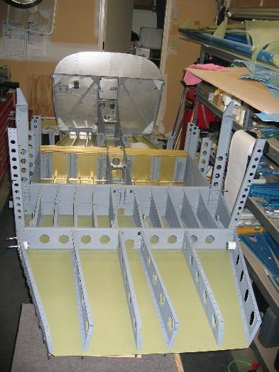

Brief Description:  Mating the forward and mid fuselage sections
28-12, Steps 2 & 3
Riveted all the floor ribs and both fuselage bulkheads to the forward fuselage bottom skin.
28-12 completed per plans.
28-13 Steps 1, 2, 3, & 4
Brad stopped by this afternoon to assist with these steps. Riveted the firewall assembly to the forward fuselage bottom skin. Bolted and riveted the forward center section bulkhead to the forward fuselage ribs.
Mated and bolted the mid fuselage assembly to the forward fuselage assembly. I picked up some slightly smaller bolts from Lowes and am saving the proper bolts for later to minimize the risk of damaging them.
28-13 completed per plans.
Front floor ribs riveted to the bottom skin
