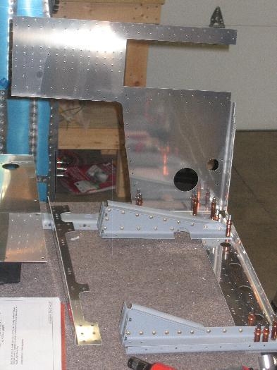

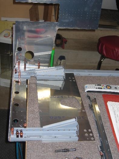

Cleco the left forward fuselage bulkhead sub assembly together that comprises of the bulkhead side channel, center section side plate, forwared fueslage bulkhead, outboard forward seat support, inboard forward seat support, and attach angle. Final drill all holes per plans. Repeat for right side.

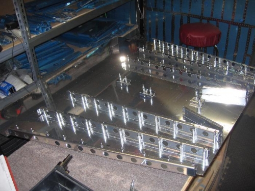

Cleco the forward fuselage bottom skin, right/left forward fuselage floor ribs, flo scan mounting bracket, and the fuel filter brackets together.
RIght forward fuselage bulkhead sub assembly
Left forward fuselage bulkhead sub assembly
Forward fuselage bottom skin and ribs
