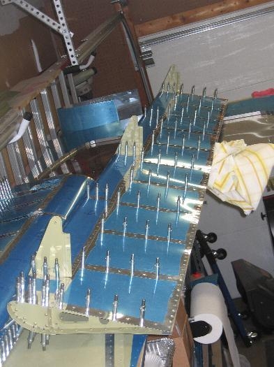

Brief Description:  Riveted bottom left flap skin and continued right
22-7, Step 5
Riveted bottom left flap skin to spar
22-6, Steps 1,2,3,4,5, & 6
Finished assembling and riveting the outboard rod end assemby, inboard rod end assembly, and the left, right, and center hinge assemblies for the right flap.
Cleco'd right top flap skin to the spar.
I'm awaiting a #33 drill bit from Cleaveland to finish the flaps. I am surprized that Avery didn't include this bit size in their kits, due to the number of blind rivets to install.
Left flap awaiting the next steps
Right flap spar and ribs
Right flap top skin cleco'd.
