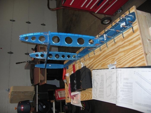

Brief Description:  Counter sinking VS-1008
Countersinking VS-1008 and clecoing the rest of the VS frame, Steps 1 and 2. I trimed the corners on VS-1013, VS-1005, and VS-1006 to ensure that they wouldn't distort the VS skin when cleco'd. It took several attempts and I took off slightly more than 1/8" before the stress was removed when the skin was cleco'd.
Cleco the ribs together
